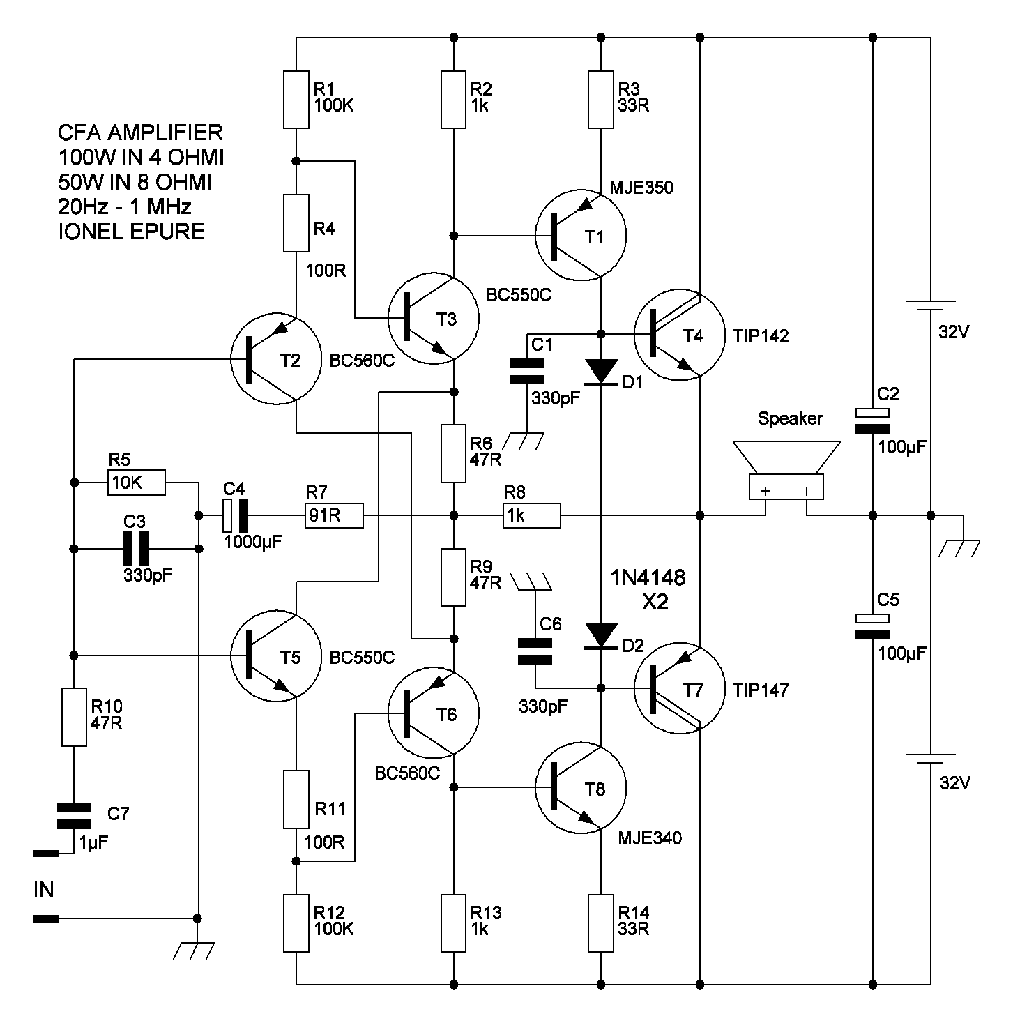

AMPLIFICATOR ÎN CONFIGURAȚIE CFA CU FINALI DARLINGTON
Epure
Alimentat la + - 32V debiteaza 100W in 4 ohmi iar la + - 41V 100W in 8 ohmi.
